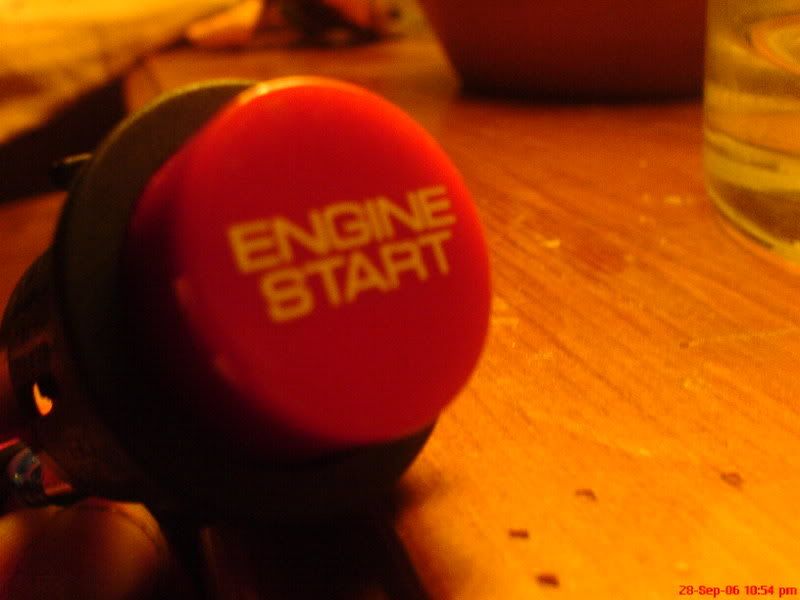

right, i have now found the lead for my phone so i can add pictures from months back! Som i will try and put them in some sort of order....
My Corbeau clubmans and corbeau harness
My car about 4 months ago with the inner wings still there
My miglia archers ;)
he magic red button
