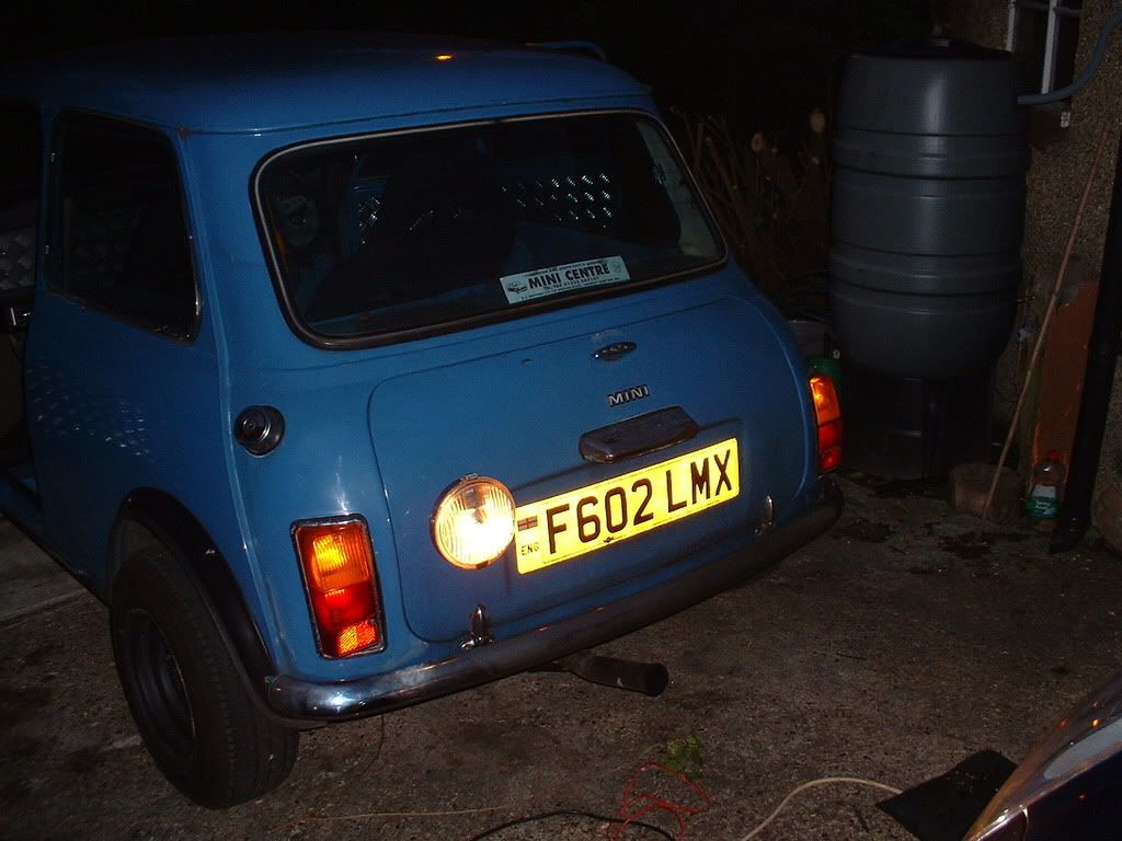

Was down on the sunday, pictures of the new lights:
Not bad for £12 :-
