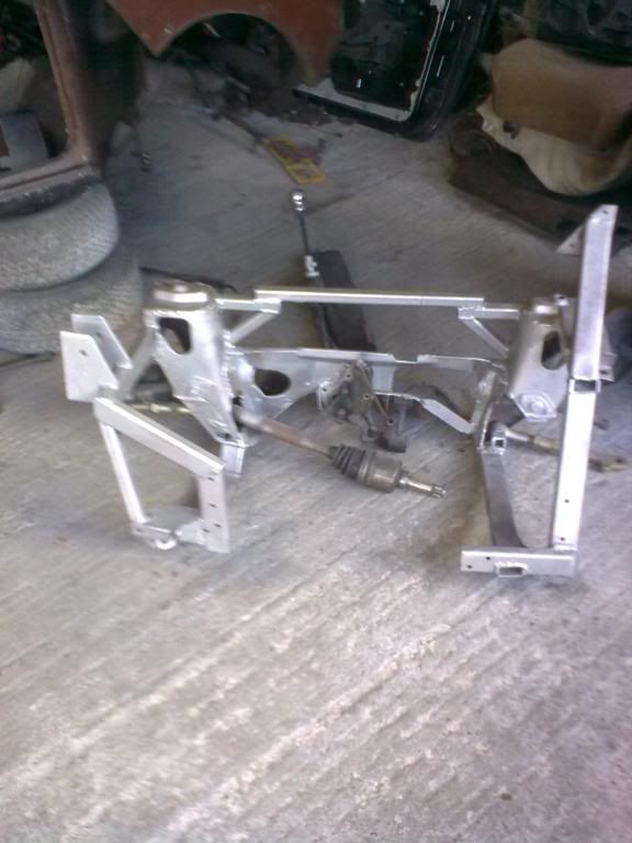

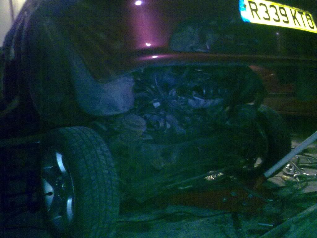

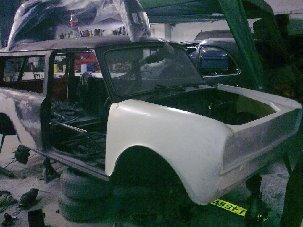

Well today i wasnt planning on doing much to this due to being busy at work, but i got the change to give the subframe a quick lick of paint, its not great, but im in a bit of a rush now, as i think i have set myself a task that im not sure ill be able to meet, but ill give it my best.
After i pained it i fitted it back in place:

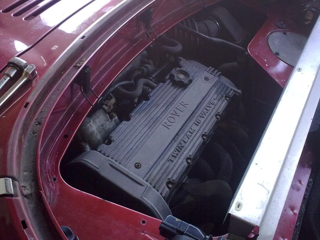

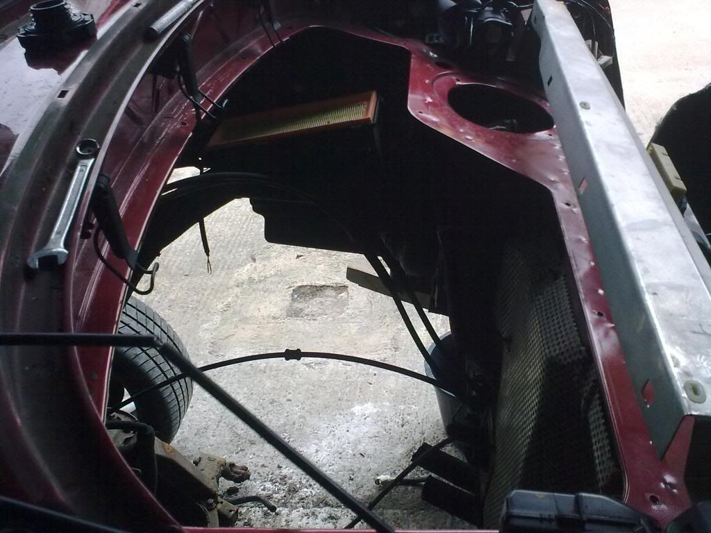

Then before i went home i decided to strip a few bits off the MFG, so i got some bits out the way and found a big plate that could be removed to revile the engine :wub:

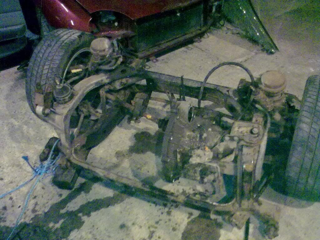

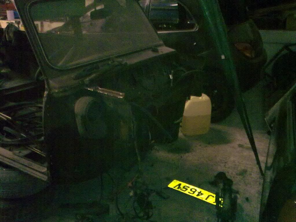

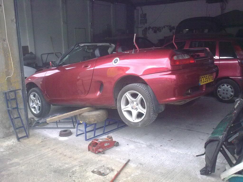

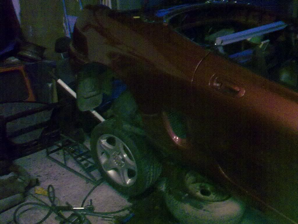

And just before i left i got the back end up in the air ready for when i come round to get the engine out:

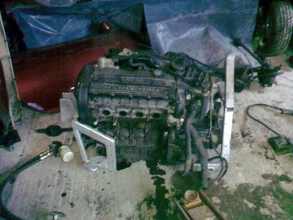

So i went home had dinner, etc.... then though what the hell ill go back to the unit for a couple of hours and make a start on getting the engine out, and my got this thing is worse than a mini on the rot side of things!!! I managed to sheer 9 bolts, which was good for me as it meant the job was quicker, but imagine you had to put that back together lol.

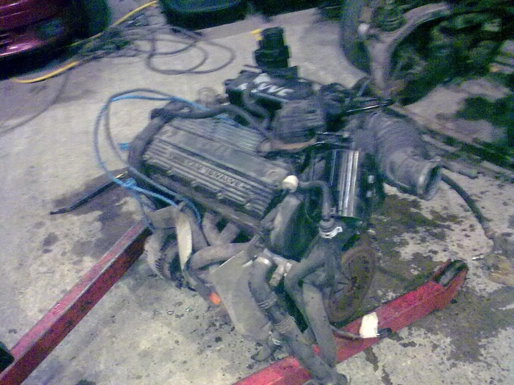

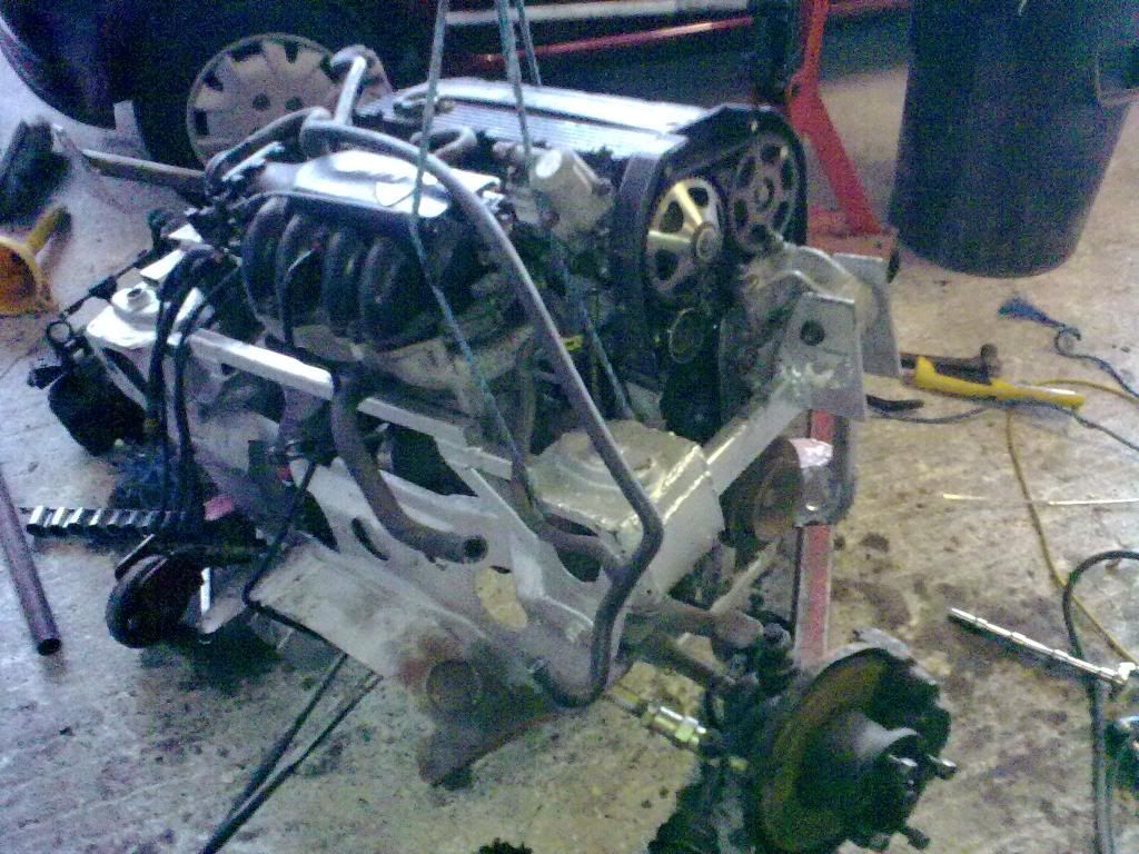

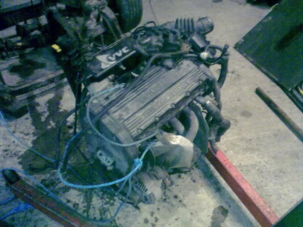

So i undid a load of pipes and plugs and labeled them up, then started to drop it out. Down it goes:
And now its down i can get to the last couple of wiring plugs:

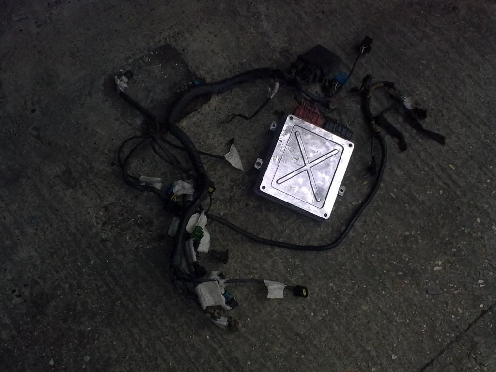

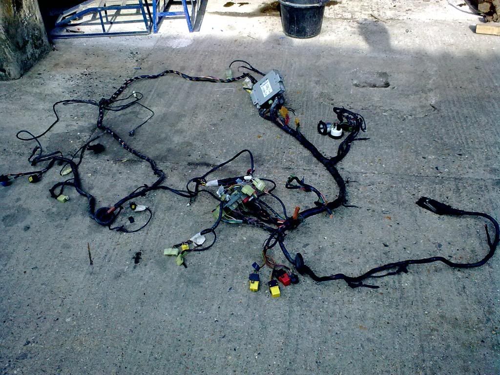

Then i got the engine bay loom out all completely labeled up:
Then i spent ages stripping out the rest of the loom, cutting off all the plugs i dont need (e.g. headlights, dash switches, etc...) so now i know once i get round to stripping the loom back those bits can definitely come off.
Then i split the engine from the box and running gear, so i can take the flywheel off now and swap for my 4 pole one from a 1.6
And now im left with this, but ill be using that for something else.

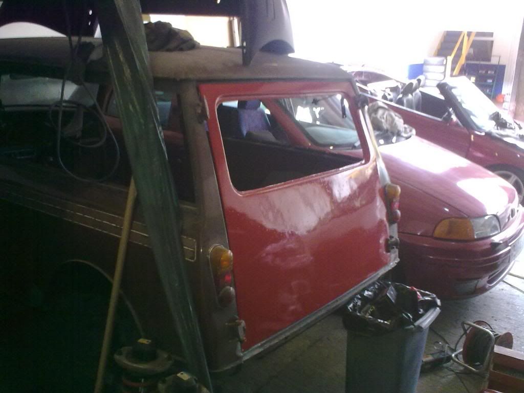

Also my single skin rear door arrived today:

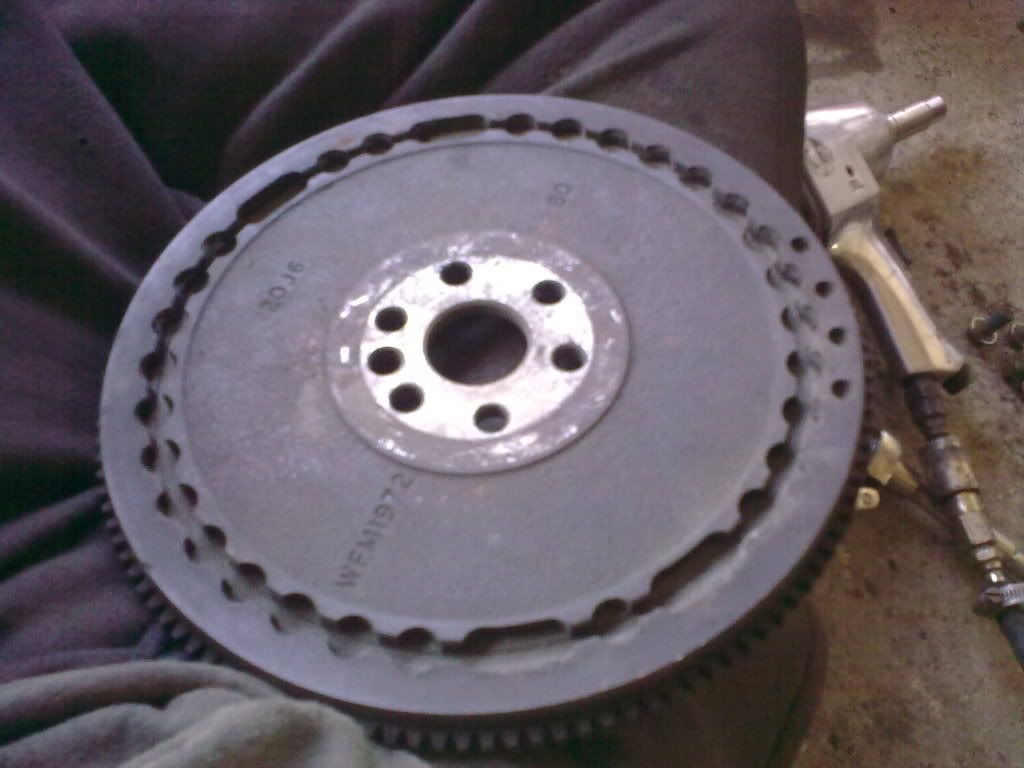

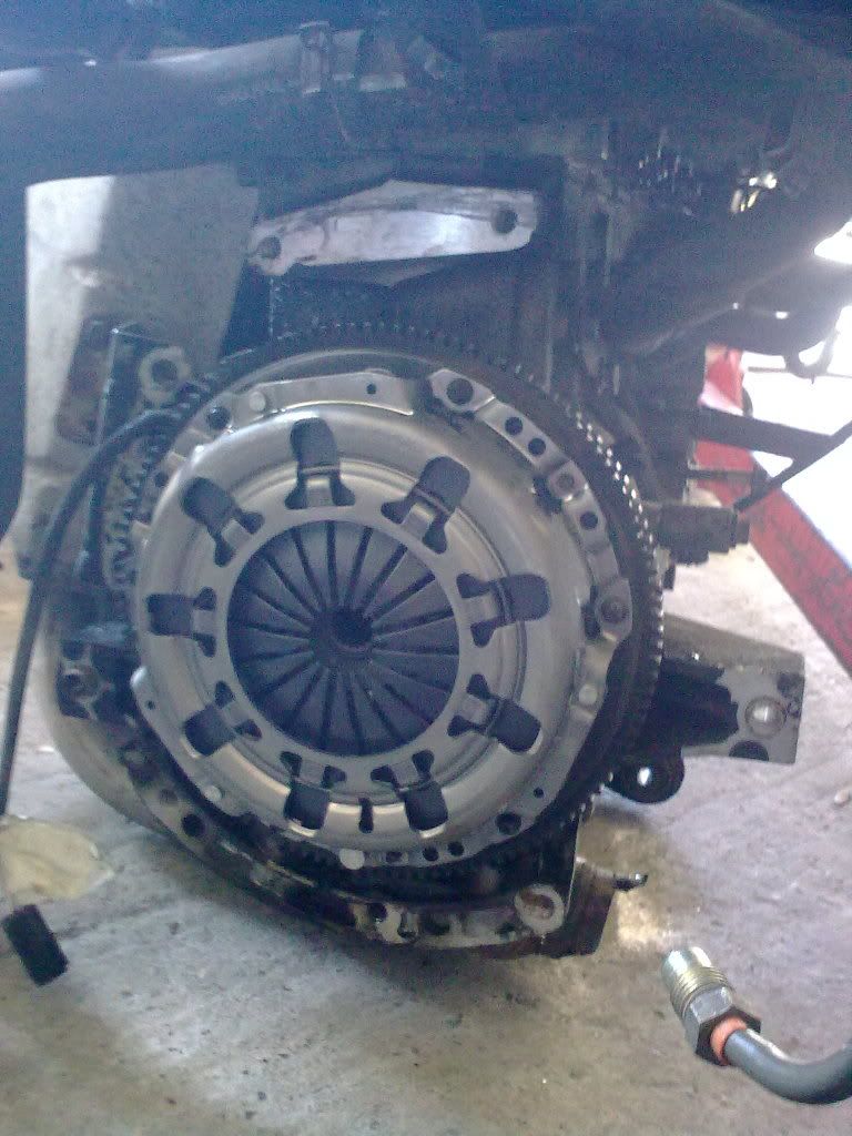

I did got the 1.8 flywheel bits off though and fitted one of my spare 4 pole 1.6 flywheels:
Also i managed to buy a new clutch kit (£88 out of pocket) and got that fitted aswell:

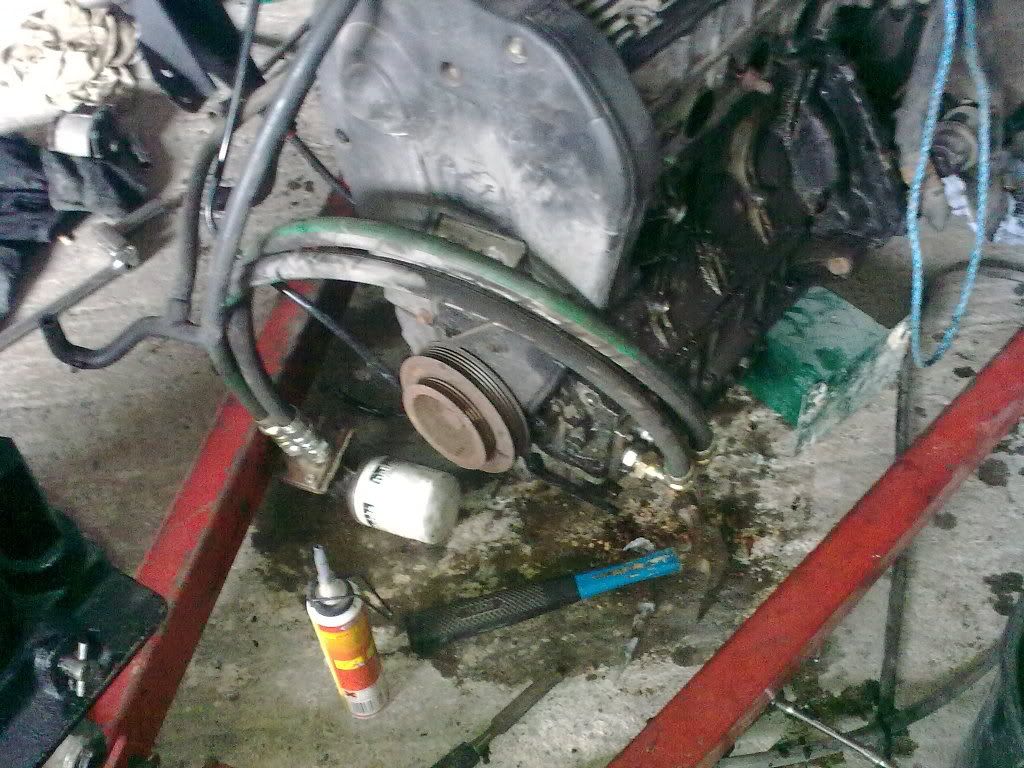

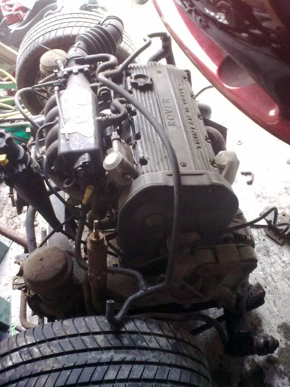

Finally i took the exhaust, oil filer and alternator off an tested the remote oil filter:
I tried to bolt up the engine side mount but as the mount it off a 1.6 its different, although the bolt holes are in the same position, the bore of the holes are to small, so ill have to try and find somewhere to buy a massive drill bit as its either two M12 or M14 bolts.

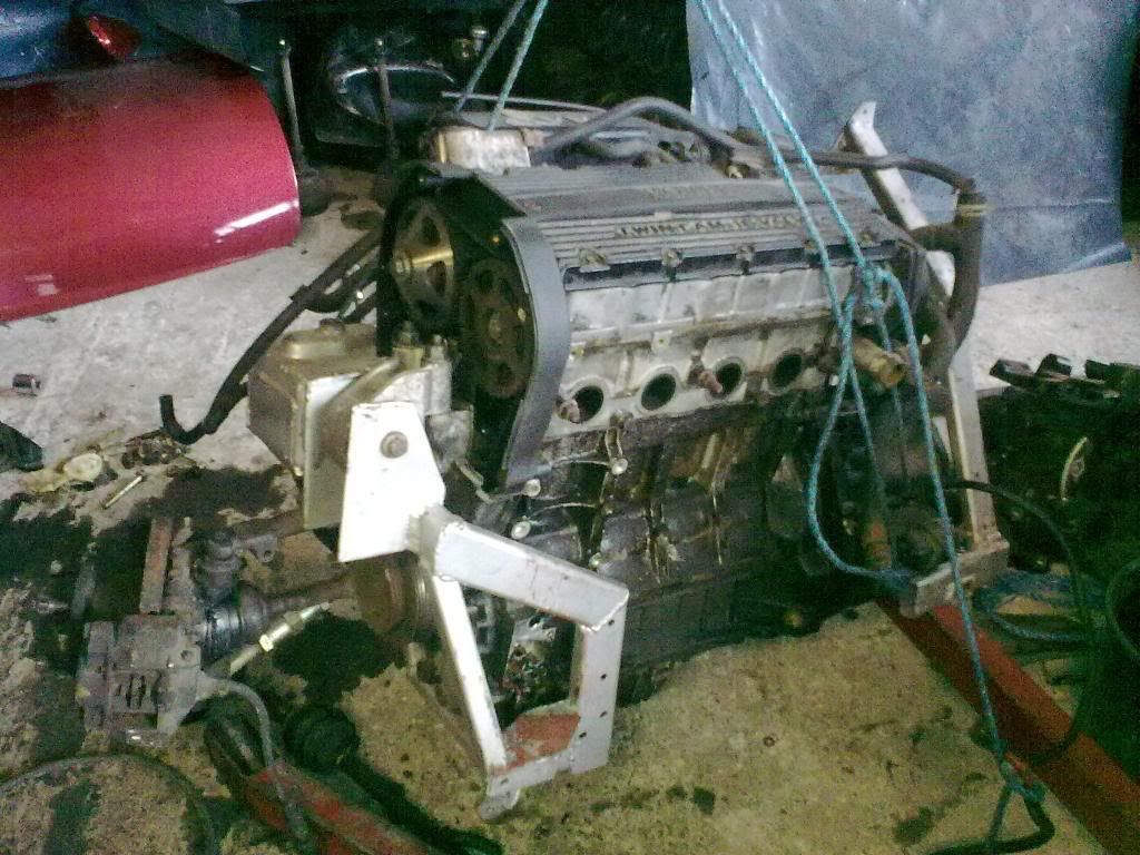

Well what a bugger, i went and spend £14 on a bloody drill bit, drilled the mount out, to find it doesnt bolt up anyway as they holes are in different positions :) Wish i had checked that before!!!
Anyways i had to go and pick up a couple of salvage motors, so popped into a scrappy whilst down there and got a 416 engine side mount.
So got back fitted that up and it was spot on :)
Then i got the gearbox fitted up, but i had to change the mount to match the mount that was fitted to the frame, but thinking back to it now the mount was the that was on the 416, so this makes me think that i might not be fitting a R65u box, so might have a higher final drive, which would be no good for the mini. So i think ill probably take it all back off now, wish i thought about that before!!! :thumbsup:

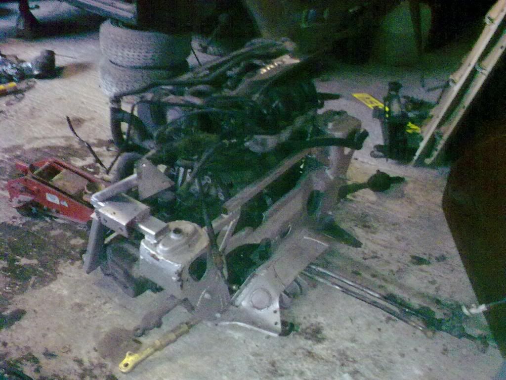

Well anyway stepping back from that now, i got the engine into the subframe, and its very very tight like only a couple of mm clearance in places.
Engine sitting in place:
Engine side mount fitted:
Gearbox mount fitted:
The linkage all worked properly, although that doesnt really matter now im going to swap the box over lol.

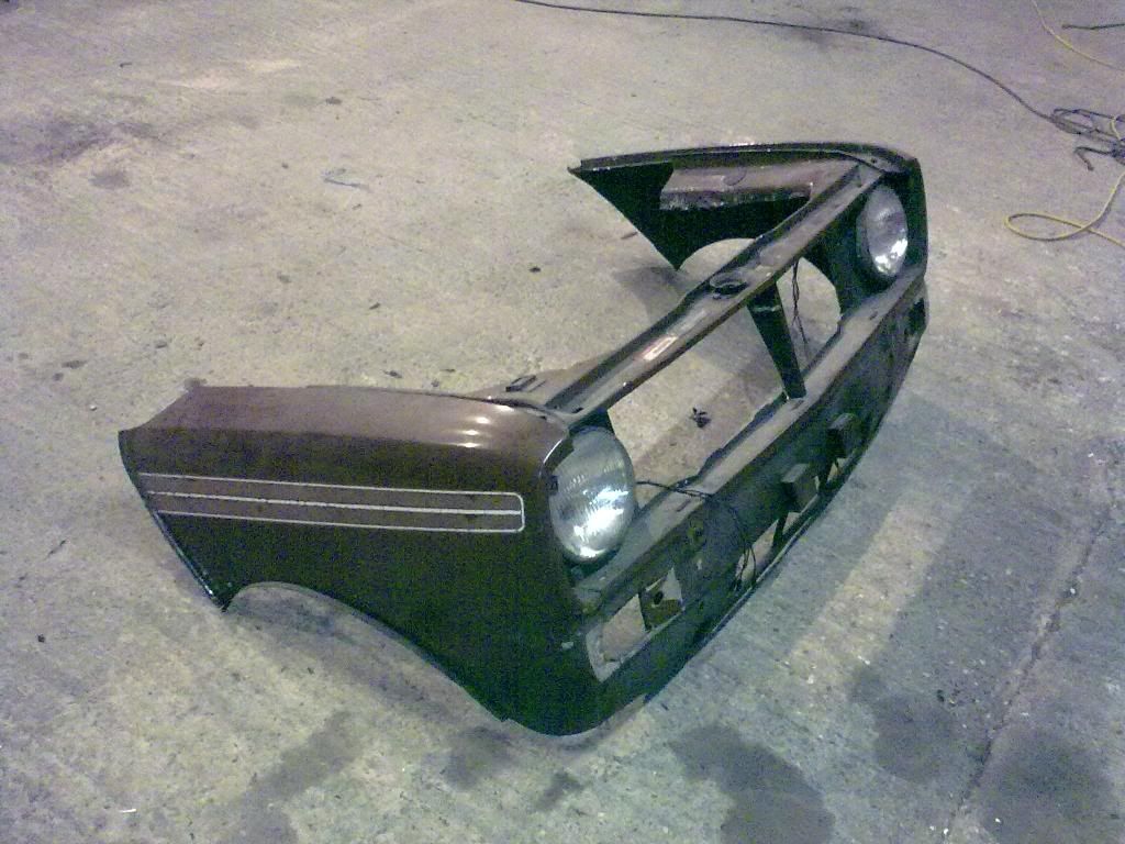

Then i did this:
Not sure if i will fit the metal front back on or my fiberglass front, will probably go for the fiberglass front as its so much lighter and wont rot:

hi mate where did you get the take off plate for the oil filter? looking good mate
It cam in the bits i brought with the original engine, but its a 5mm aluminum plate with two 10mm holes in position of there the oil leaves and returns, then these holes have just been tapped and the tack offs fitted, simple but effective.
