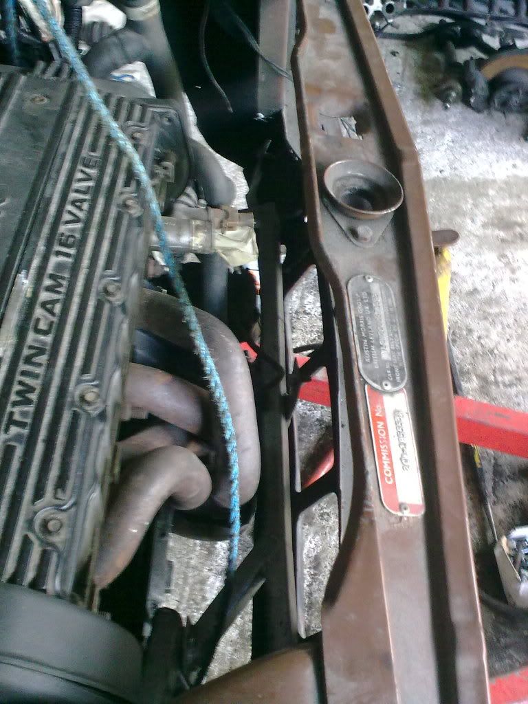

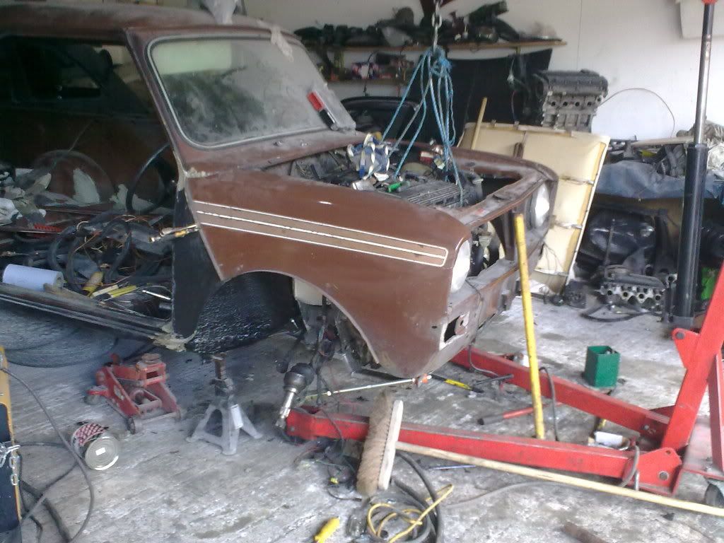

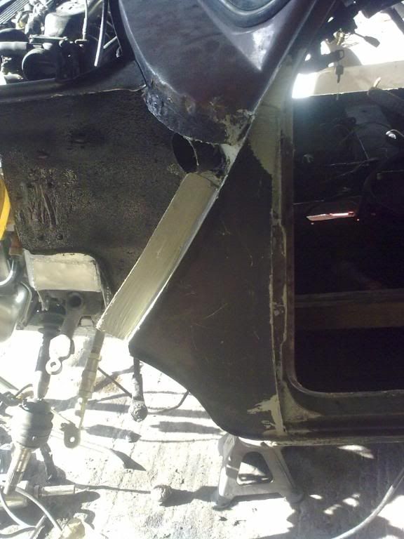

Today i got both the a-panels fitted:
Offered the front up to make sure i had clearance on everything, which i do :D:
and heres a pic of the clearance at the front, so luckly there is quite a bit :-, so i should be able to get a nice rad in there hopefully:

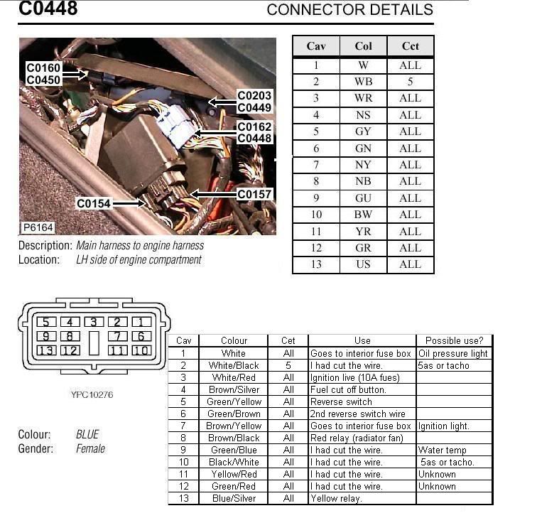

Also iv started to decode the MFG Engine loom to main loom wiring plug, still got a few to work out, but considering that was the part of the conversion i was dreading most, i think it might turn out to be pretty simple, but im sure iv spoken to soon.

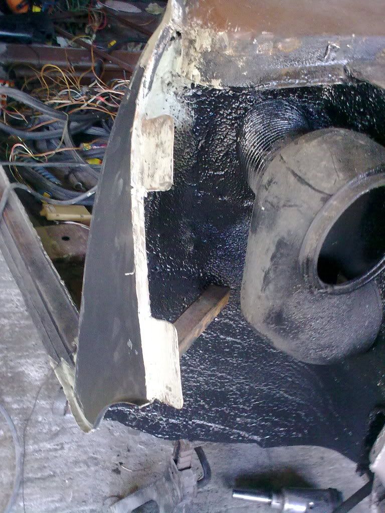

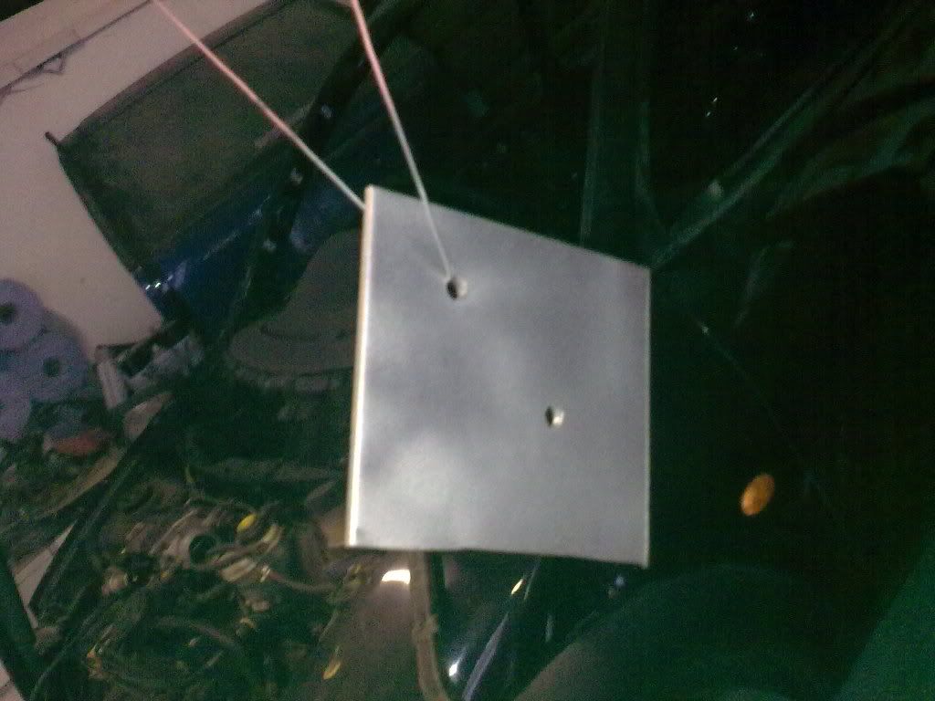

Iv not been able to get much done on this for a while, but i got some time to get some done today.

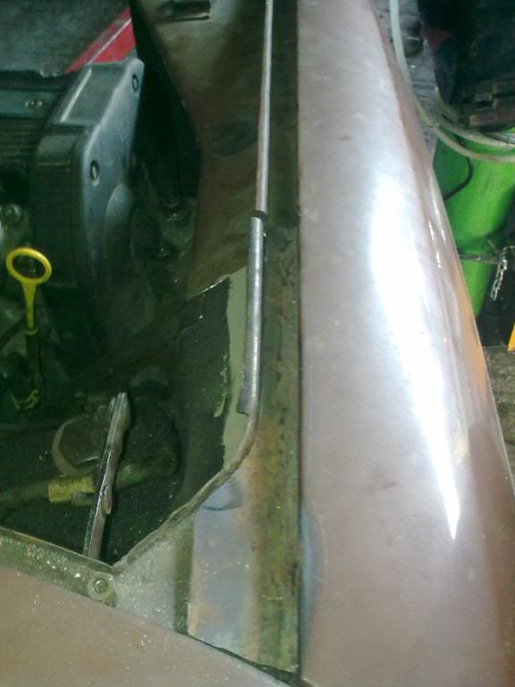

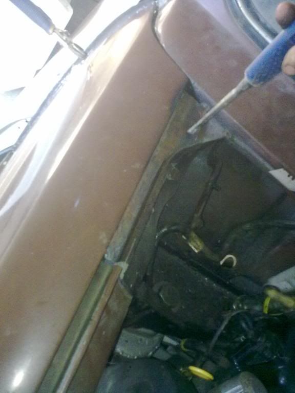

I started out by making up some plates to weld to the inside of the front end so i can secure it there aswell.
And welded in place, i also did there other side, but didnt take any pics:

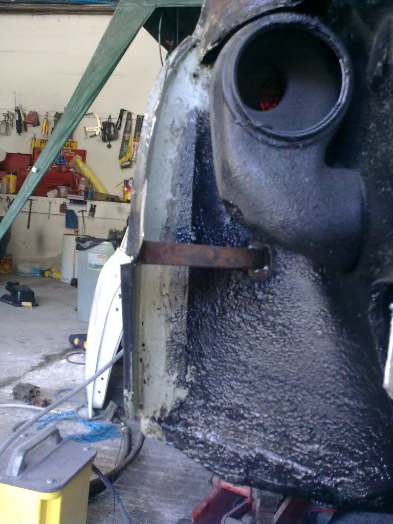

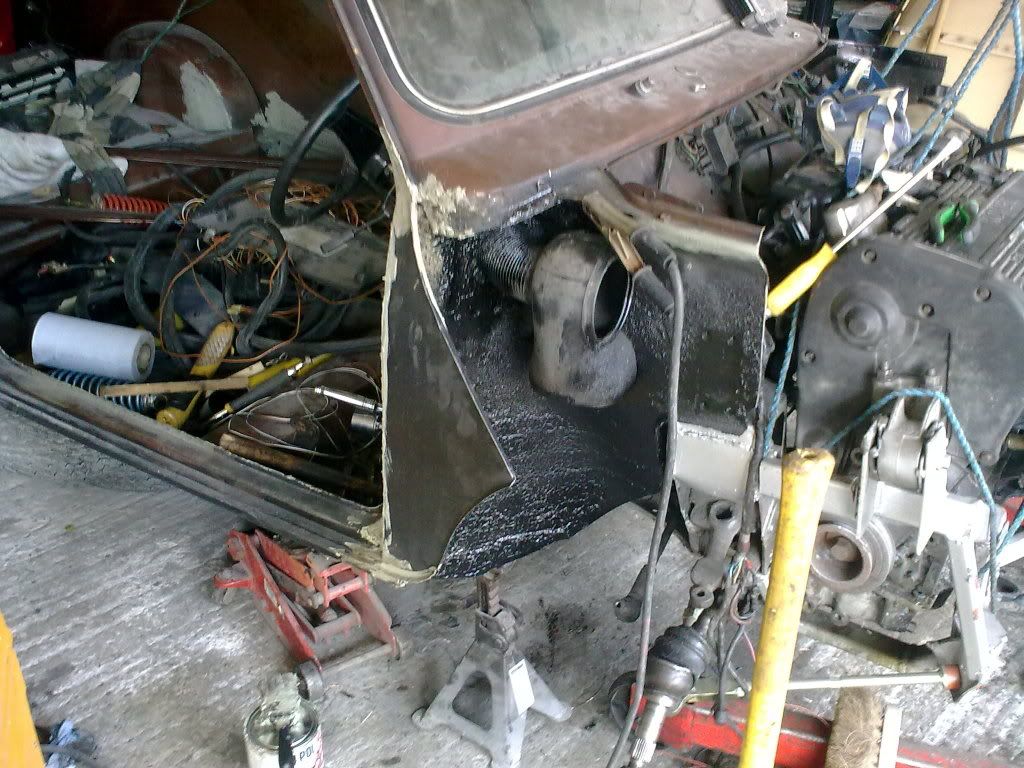

Then i fitted some plates to the a-panels to secure the front end to:

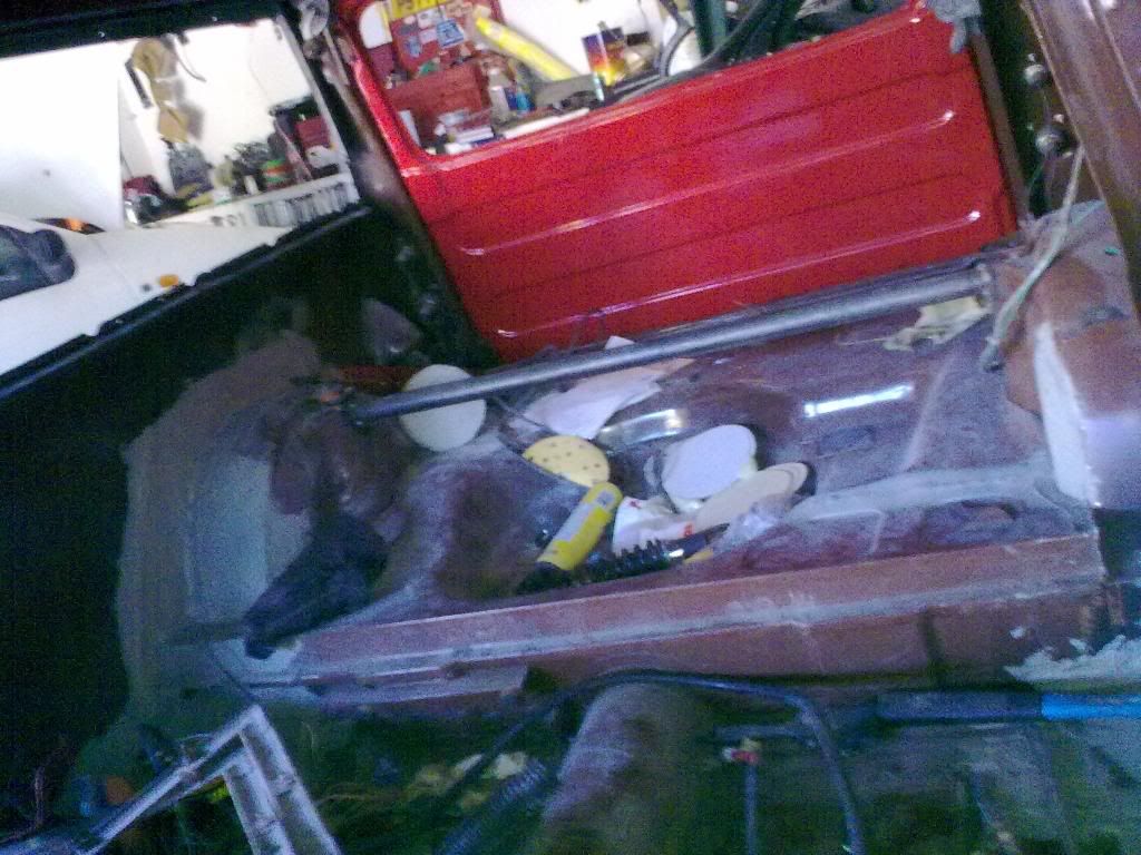

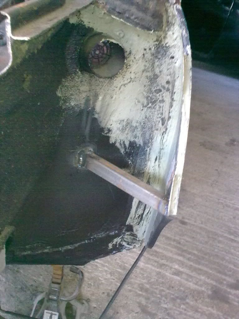

Also i decided to fit some support bars to the a-panels as they flex a bit on my green mini.
I know the box section is an over kill, but its all i had to hand and i know now its not going anywhere lol.

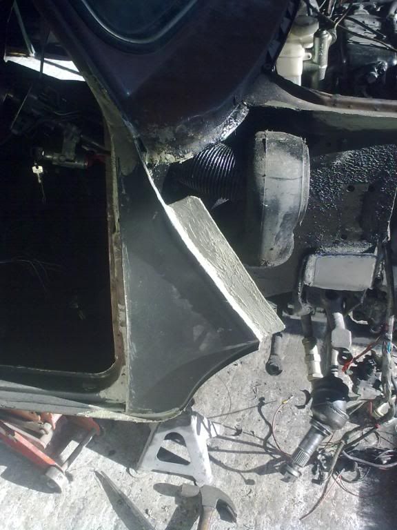

Then to get a better fit i modified the a-panel plates:
I then made up some thick plates to go on the floor to give some extra strength, as the floor cracked on my green mini when i had the 1380 in it, so i though ill need double strength for this :P

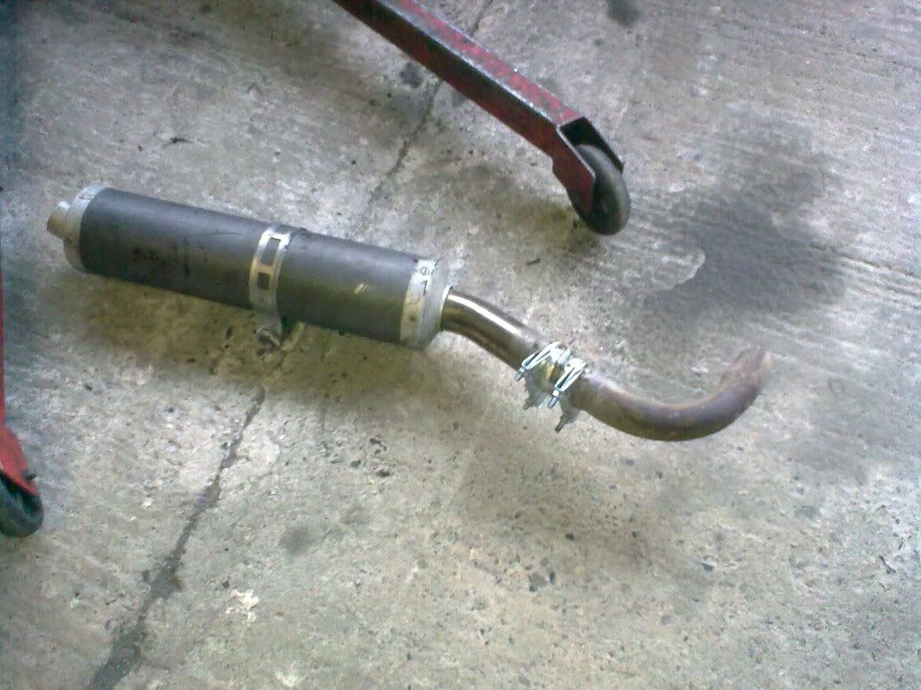

Then finally i revived my R1 backbox, so i offered that up and the pipe needed bending slightly, so i put it in the hydraulic bender, but where it was so thin the pipe just started to crush and not bend, so i cut up one of my spare exhausts for the bend, cut the pipe down on the R1 can and offered it up in place. Then i took it off and welded it up, but then i gave it a wack as i wasnt sure what metal it was on the can and it just cracked off the other side of the weld :genius: so i welded over the weld i had just done dragging it right up the pipe. Now i know this wouldnt last, so i got an exhaust repair and a couple of clamps and fitted that waswell leaving me with this:
So now all i have to do i just cut the curve down and weld it to my center pipe :teehee:

if trying to bend thin tube, pack it with sand or something, obviously blocking the ends up, it should help hold the shape a little bit better...little late i guess :P

Yea i did know about sand or packing the pipe out, but i just thought i would try and see if it would bend and if it did bonus if not then ill just make up something lol, but i was unlucky >:dontgetit:

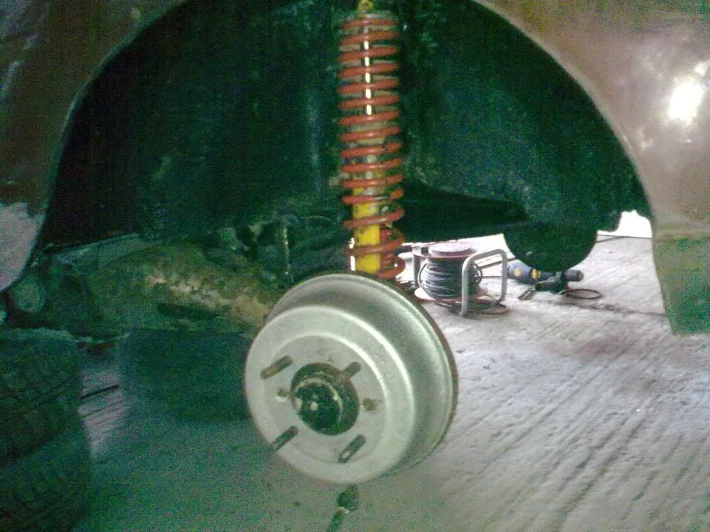

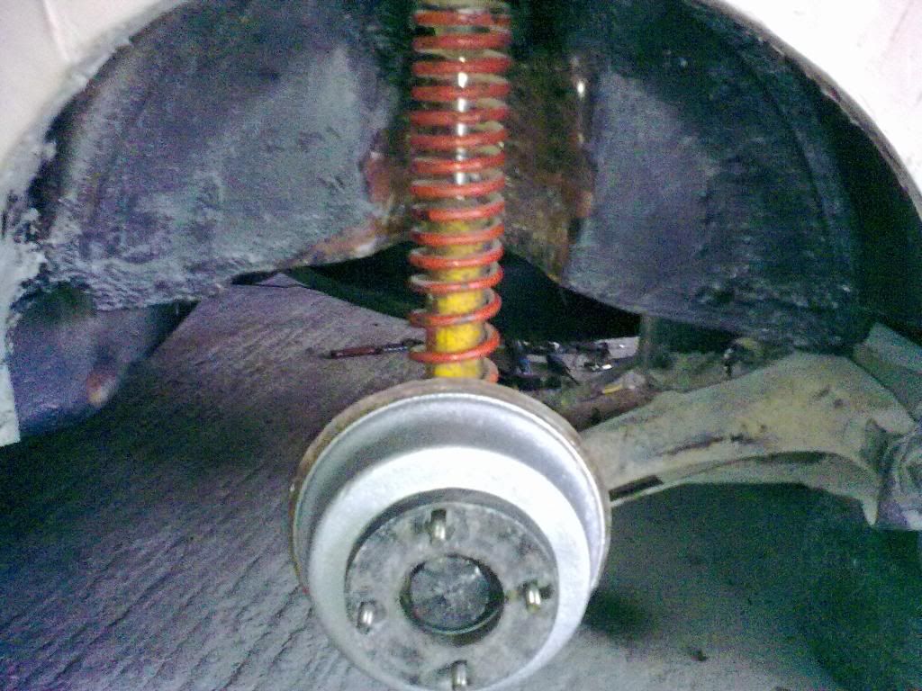

I started out by offering up the coilovers and although they dont have an offset top in they were only a couple of mm away from the top hole, so i just got the hammer out and beat the arch a little bit and they fitted with no rubbing :thumbsup:
Then i made up a rear strut brace and welding that in place:

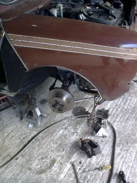

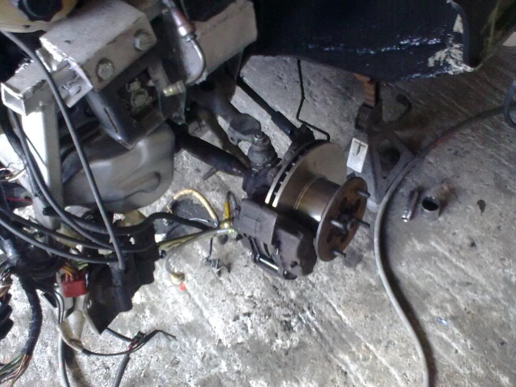

Then i started fitting the front hubs and vented disk and flanges:

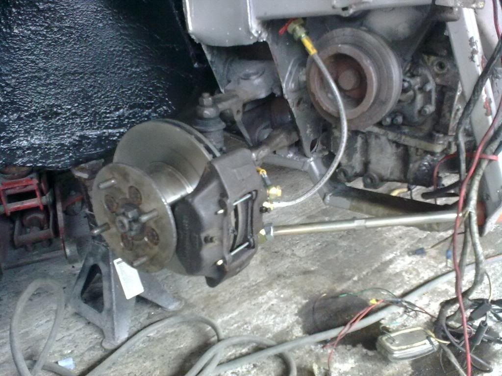

Then i got the brakes built up with the new fitting clips and pads and fitted them:
