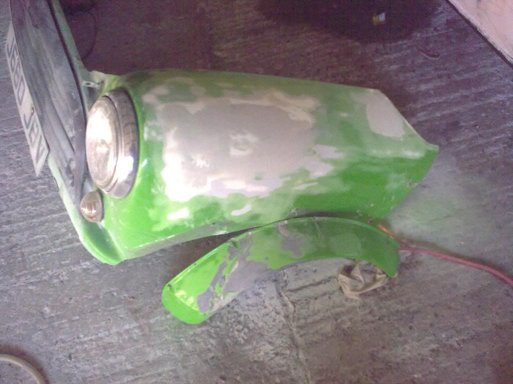

One nice part repaired mini flip front and arch:

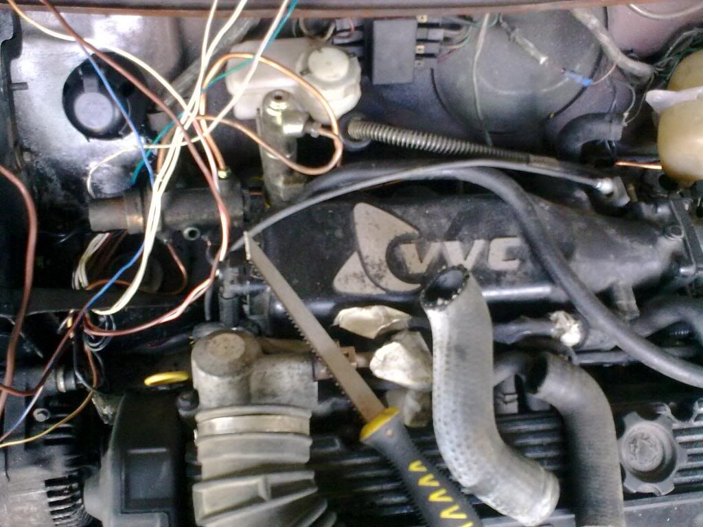

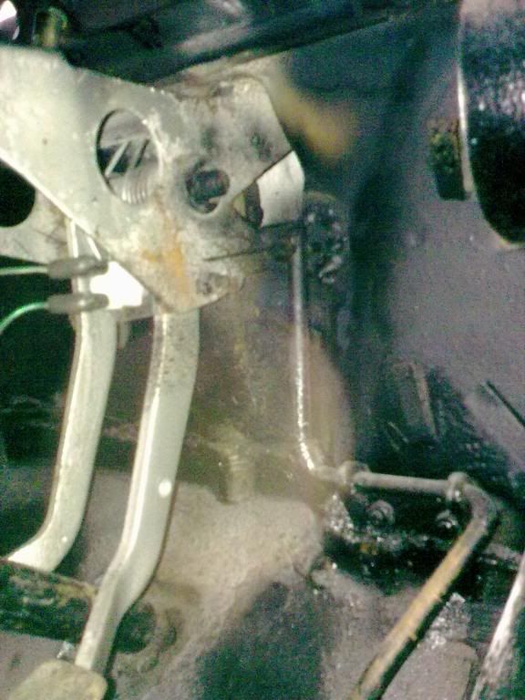

Throttle cable in place:
And secured at the pedal:

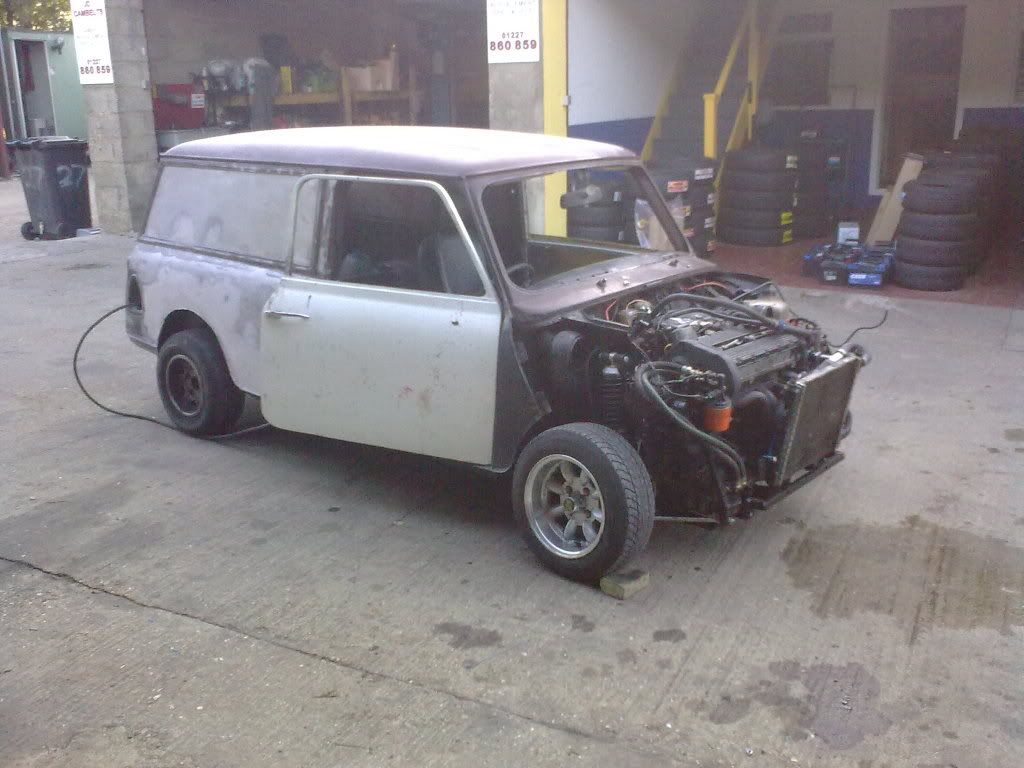

Then yesterday i started pluming in the coolant system and got that all in, its all fine apart from a very small leak in the t-piece i made, so ill get welding on that today and seal it.
Also got most of the fuel pipes done, but got to fit the return to the tanks now.
And just so you all believe me that she is running, videos a bit crap as the vacuums were all open etc...:
