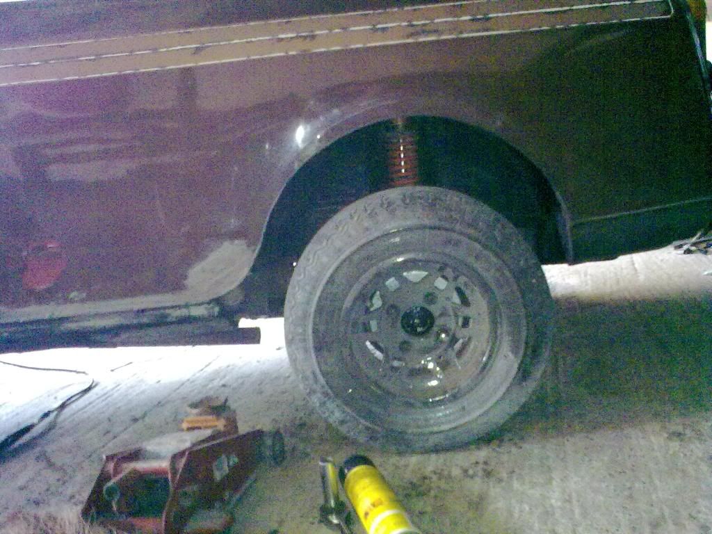

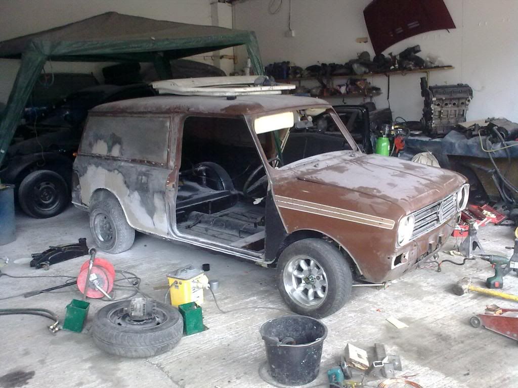

I put wheels on the back and lowered it on to the floor to find even on the lowest setting iv got 5 1/2" between the top of the wheel and the arch!!! So ill either have to try and find some other coilovers of add some majorly tall turrets.
This shows the massive gap:

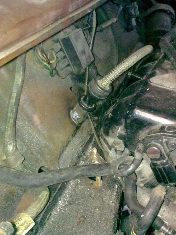

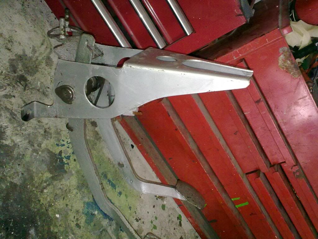

Then i finished modifying the clutch pedal and built it back up:

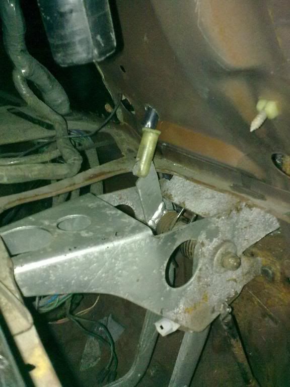

Then i made up a spacer block to go on the engine side of the bulkhead for the clutch cable to pass through:
And the cable connected up to the pedal (looks slightly off line in the picture, but that was just due to the block not being lighned up and welded at this point) :
And welded in place:

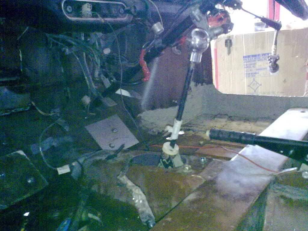

Then i got the holes drilled for the linkage and fitted that (only finer tight at the moment) and i can get all gears :thumbsup: :

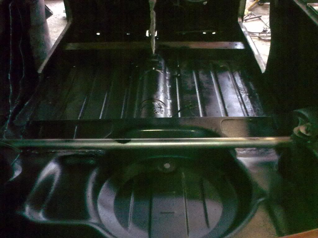

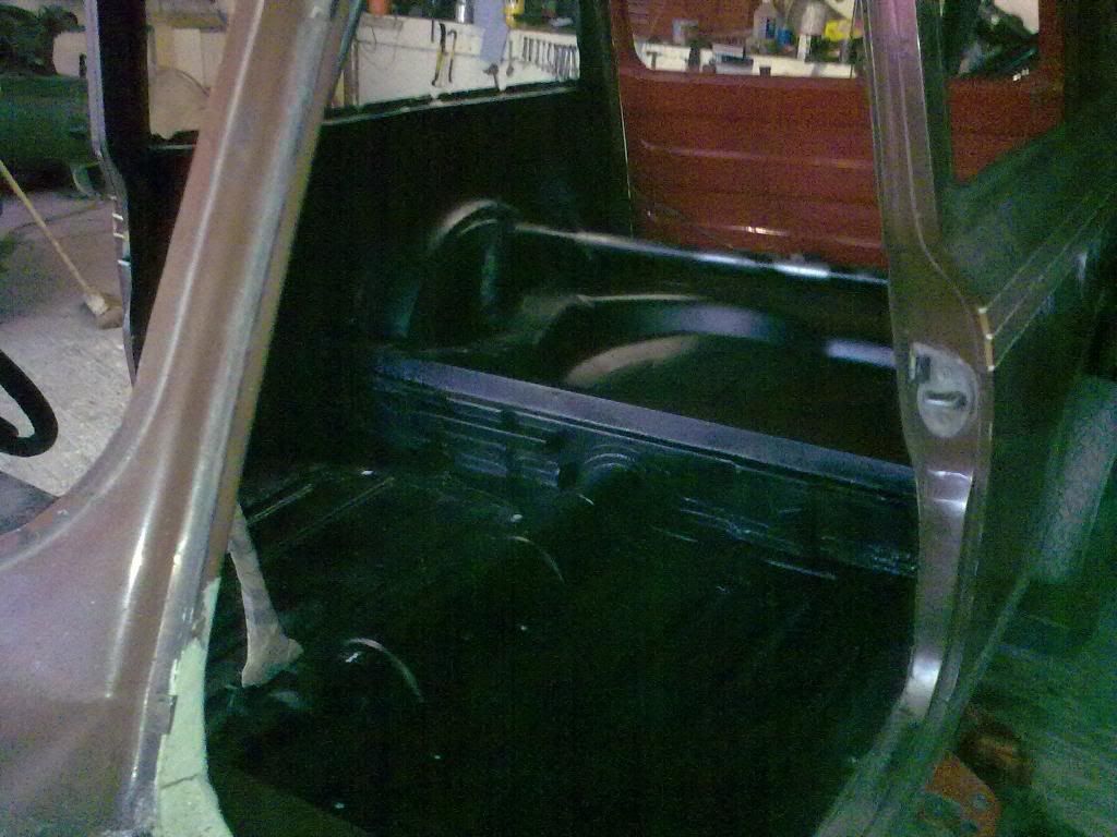

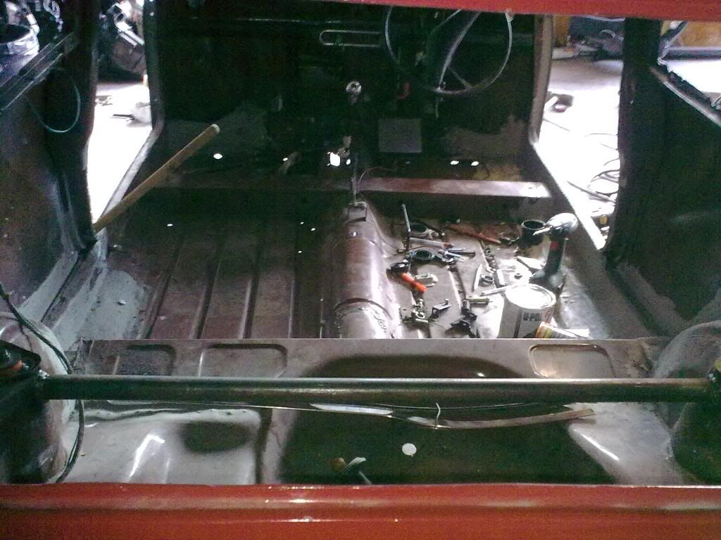

Heres a pic of what the floor looked like:

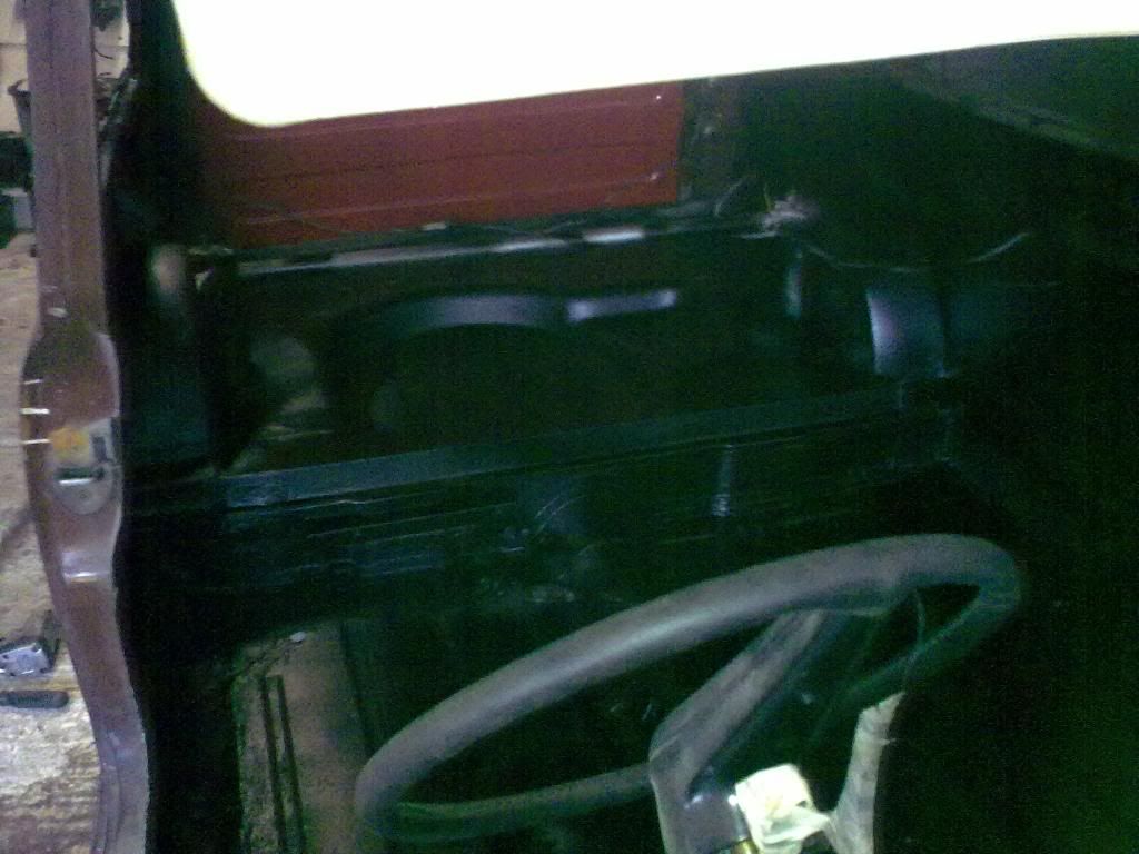

Then after some stonechip (I love the effect stone chip gives, so i thought i would do the whole inside but i will be fitting front carpets.

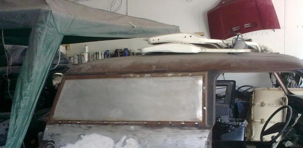

Iv also cut the panels and welded them into the rear 1/4 window frames, iv fitted the drivers side, but still got to fit the passenger side.

Tomf what make are your coilovers? i have AVO and had the same problem. so I had to move the mounting up by about 10cm. I have made it adjustable.
I got a metal tube and welded a 3mm plate to the top and slapped that in. Took about an hour to do.

Yea i think ill have to do that, but i left the rears off the stands for a couple of days and it seems they have settled with about a 4" gap between the tyre and the arch, so before i go cutting up the arches i think ill leave it for a little while so i can drive with if for a little while and see if it will settle any more, then ill mod the arches so i know how big i actually need turrets to be.
Cheers for the picture ill do something similar to that.

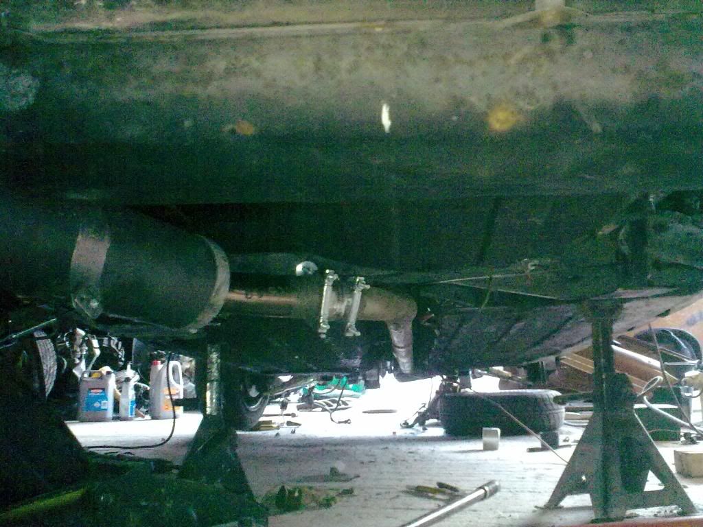

I havent been able to do much since the last up date, but im still clawing asway at my massive list of things to do.
Iv got most of the brake lines done now.
I had to source a different engine side mount as my frame was built using an early 214 engine mount and no one near me had one in the brakes so was a pig to get hold of. but i managed to find one today so iv got that fitted up now.
Iv also changed the rear wheels bearing and fitted now drums.
I finally found the parcel from minispares that the postman left with the farmer (nowhere near my workshop and i never speak to him...)

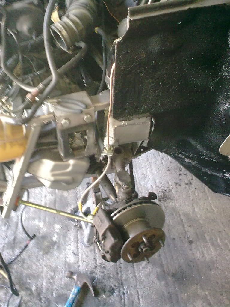

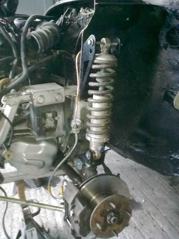

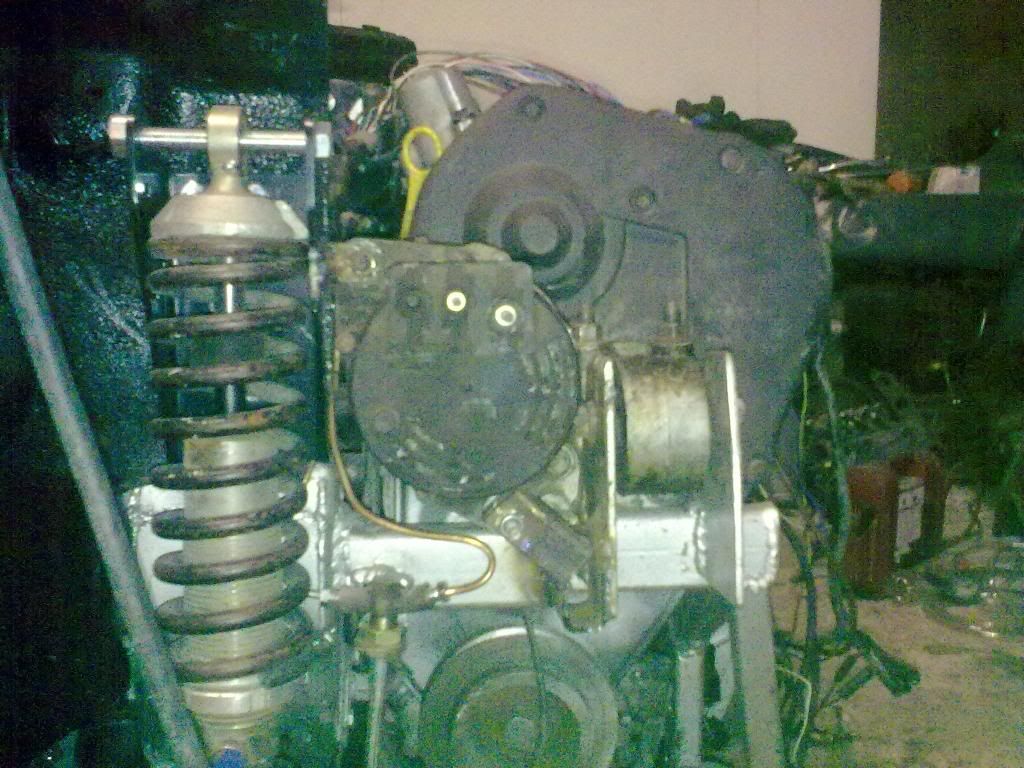

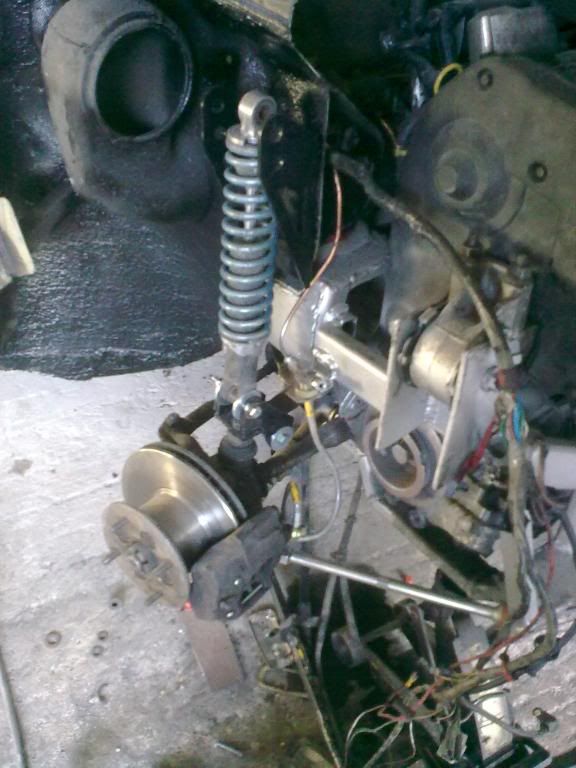

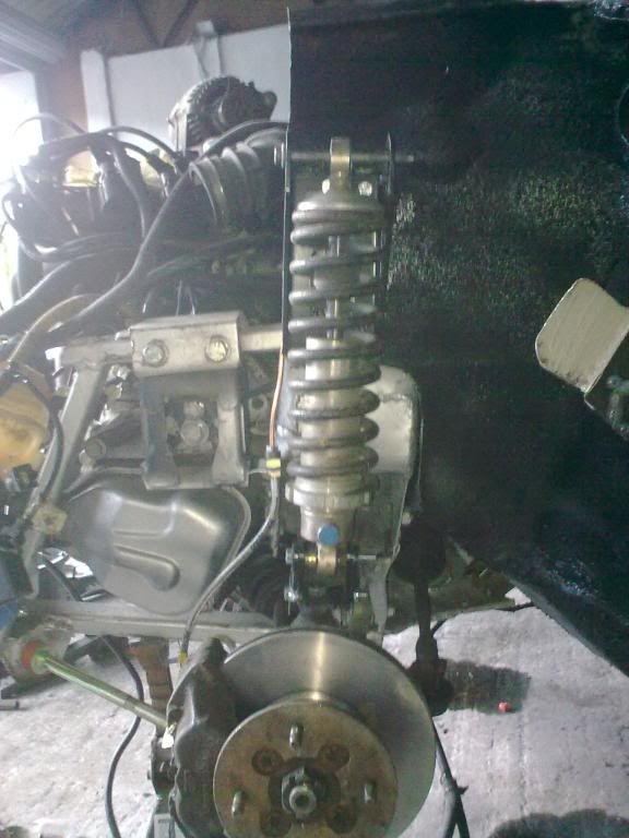

So i fitted up the coilover mounts along with the front coilovers:
Then i put the wheels on and let it off the stands to find it the coilovers had nowhere near enough strength in then as the front was about 10mm off the floor so i tried my bigger coilovers and they were spot on and are fully adjustable:
And this is how it sits with them:

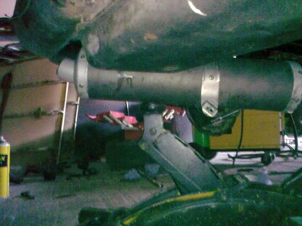

Iv also got the exhaust fitted up, (not quite in the pics but it is done now)

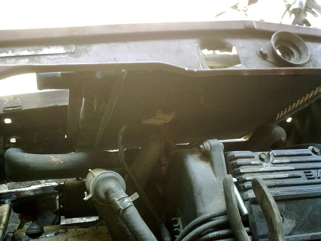

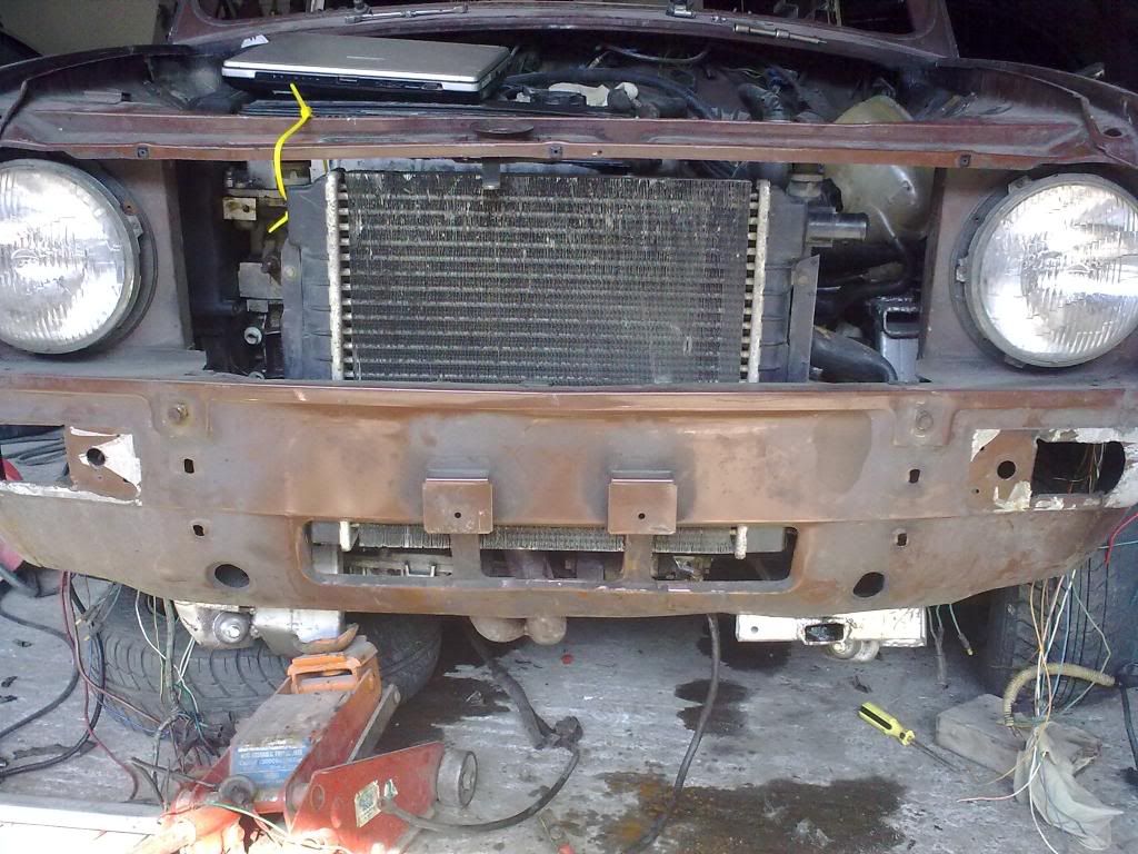

Chopped a bit of the front and it means i can get a KA radiator perfectly in the front.

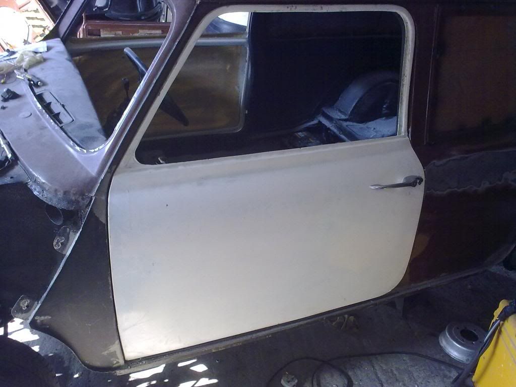

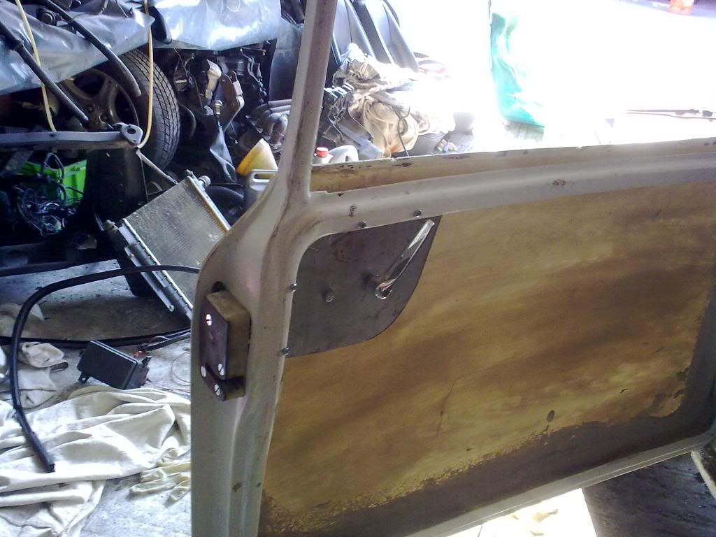

Iv also started on getting the fiberglass doors fitted. The passenger side is done and lining up nice and the lock mechanisms are all working now but i started out by doing the drivers side and as i couldnt find any nuts to fit the original bolts i decided it would be a good idea to weld some studs into the original latch and this was a great idea got it all fitted perfect, but the welding has melted some of the plastic on the latch and this has stopped it working properly so i mad sure i just brought some bolts for the passenger side, so iv got to source another latch for the drivers side now.

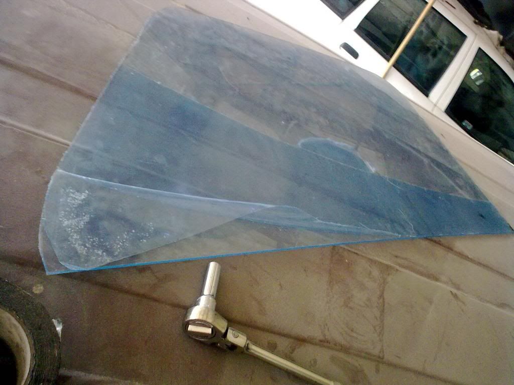

Also when looking for some polycarbonate i tried the local auto glass place and they gave me a couple of sheets so i could make some door windows, but they didnt have enough for my rear door so ill have to just buy some for that. So i made up a window for the passenger side.

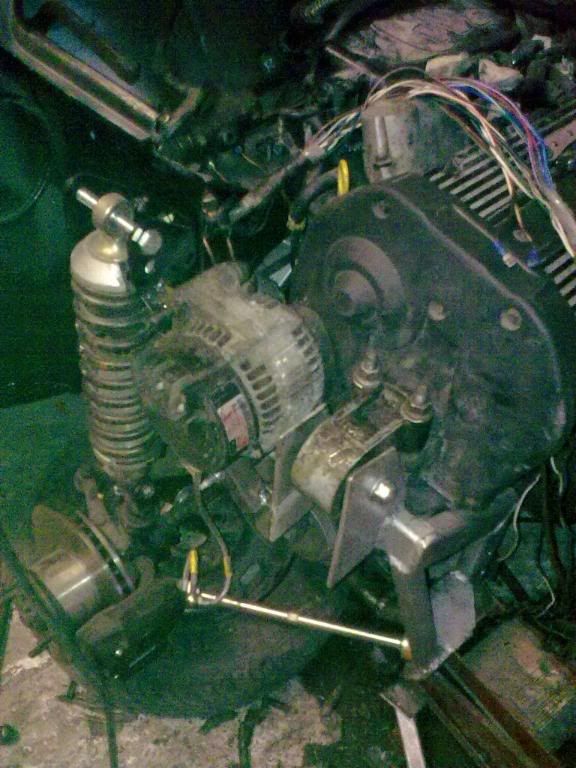

Iv also started to mount the alternator now, iv still got to work on it a bit but its sold as anything, buy iv just got to work out a small tensioned for the bottom and buy a belt.

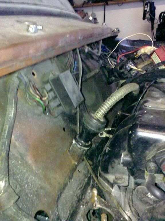

But in the mean time i have had a good friend over helping me work out my wiring problem (the immobilizer not talking to the ECU properly)
Where i have a plug for the immobilizer off a rover 400 and an MGF loom it mean that the wire colours were all work and i had connected the signal wire up to the wrong wire on the ECU, so we swapped that round and vola she runs like a dream apart form needing an exhaust manifold gasket.

Iv also made a new front support bar up so i can fit the rad in and iv made up a couple of bottom rad mounts still got to do the top mount though.
