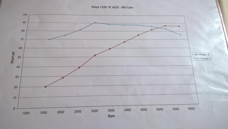

This features an RS cam with a 1330 bottom end but only a 33mm inlet valve, and uses twin hs4 carbs and 1.3roller tip rockers.

 whereas the SW5-7 on a 1380 with 1.5 ratio rockers, L3 head and a single HIF44
